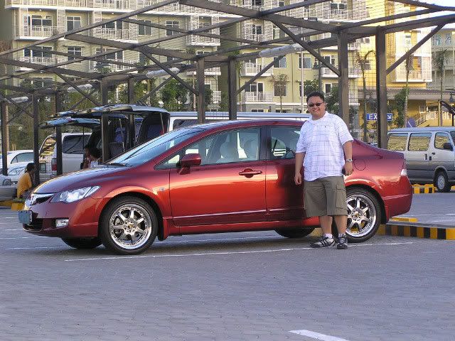

I have 215/50/17. No rubbing issues at maganda yung fit sa wheel well. Minimal lang yung gap ng fender sa tires.
Ultraman
I put 225/45 Potenzas on my 17" rims.  Perfect fit, excellent road grip.  No rubbing issues.
