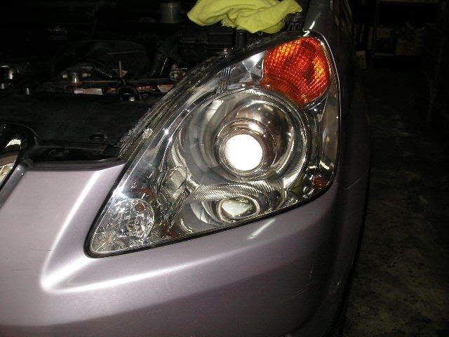

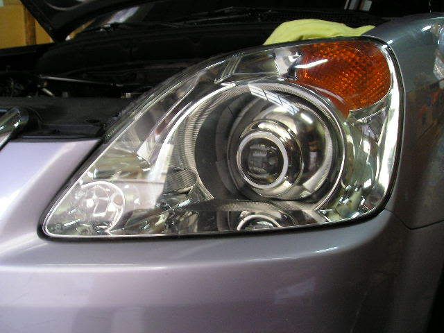

ito na, installed pics, finally natapos na din sa akin hehe.  looks kinda like the other retro that I did but I like the clean look.  stock headlights with acura TSX projectors and Philips bulbs.

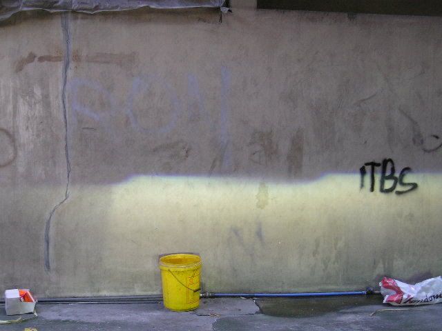

cut off sa afternoon.  imagine this pag madilim na.  hope I got the cut off right.

question lang bri, kung nagreretro ka ba may reference ka kung saan mo ibobolt ang projector? Kc dapat  plain and zero angle ang projector kung nakafit na yung headlight sa car. or gumagawa ka ng measurements pa?
bri g
thanks manga! :D  actually I use the stock H4 bulb as an alignment point to center the projectors.  pero I still need to mount it sa car itself before I seal it up to make sure the alignment is right :) kaya medyo matrabaho, have to take the car apart at least 3 times hehe.
