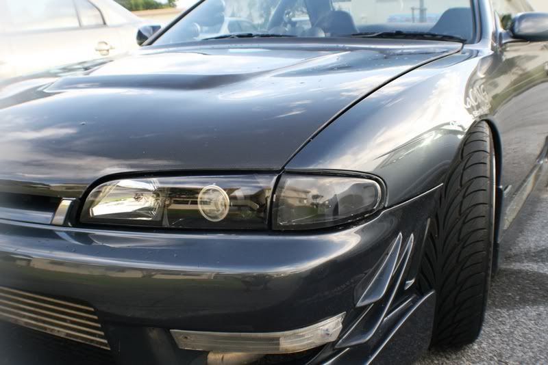

Figured id share too...
I chose the TSX HIDs because theyre one of the smaller OEM housings available.  Was not too hard to retrofit them into the stock inner house.  Dremmeled out the stock bulb holder, cut out a small square to fit the OEM projector housing and wedge it in place.  Painted all the chrome reflectors black since I wont be needing them anymore and added some supermade clear lenses.

Nice! :thumbsup: Hot s14 you got there bro  :occasion14:
