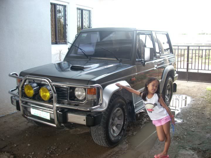

Mga Sir/s,
I would like to request for an advice regarding my plans to body lift my stock gen. 1 SWB Pajero A/T (4D56T Engine). I am currently using it as my daily car to and from to office and primarily pang porma lang ang reason kaya gusto ko siya ilift to be able to install a bigger tires maybe.... 33's or 35's.
Considering the intended tire sizes, budget constraints and yung existing Auto Transmission nya (if ever may issue), ano kaya ang height ng body lift na kailangan ko ipagawa, then kung mag 35' anong gear combination ang kailangan maipalit sa stock set-up nya para maretain yung dati nyang hatak and street performance or at least ma-improve yung existing.
eto po yung current photo ng aking unit for your reference. TIA
Regards,
Rodel
